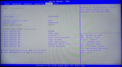

Hi LOTGS,
Please can you post a picture of the BIOS so that I can look into this in further details?
Thanks
Mats749
LOTGS
Message 10 sur 30
17 579 Visites
Message 10 sur 30
17 579 Visites
Hi mats749,
Sure. I'm not sure exactly which BIOS screen you want, so I've captured each of the main pages here.
Thanks.
IMG_20220405_211653.jpgIMG_20220405_211702.jpgIMG_20220405_211718.jpgIMG_20220405_211725.jpgIMG_20220405_211733.jpgIMG_20220405_211743.jpg
