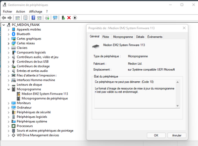

Hi,
I have exactly the same issue with a ERAZER Engineer X10 (MD 35182).
MSN is 1002 4299.
Windows 11 has downloaded something here
Restart of PC gives the following message
I understand that this is related to BIOS update but I am not an expert to resolve it.
Waiting for your support.
Thanks,
Frank

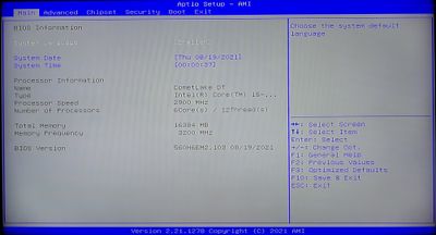

LOTGS
Bericht 10 van 30
17.487 Weergaven
Bericht 10 van 30
17.487 Weergaven
Hi mats749,
Sure. I'm not sure exactly which BIOS screen you want, so I've captured each of the main pages here.
Thanks.
IMG_20220405_211653.jpgIMG_20220405_211702.jpgIMG_20220405_211718.jpgIMG_20220405_211725.jpgIMG_20220405_211733.jpgIMG_20220405_211743.jpg
