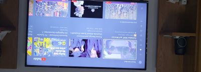

Dear Team,
My Medion Smart TV does not show colors properly. Color Restoration seems -ve(looks like a photo negative). Please check the photo attached.
TV been wkrking well since May 2022, till yesterday
Appreciate your support!!

Dear @EastClintwood
Tried all your steps, my bad luck as I had to end up with same result as before.
Picture still looks decolored or distorted. HDMI, Wireless Display from my Android Phone, Medion internal browser based videos and YouTube app videos give same distorted picture as result (same as my earlier shared screenprint).
I know TV been bought by my house owner earlier this year. Shall we try repair under warranty/guarantee as next step ?

Dear @EastClintwood
1 more observation,
None of the Picture adjustment settings(brightness, contrast, sharpness...) are working. Only Backlight + or - seems to work..
Any hardware issue ?

Dear @Vivek-Med,
Het is waarschijnlijk een hardwaredefect, neem contact op met de MEDION Service om de verwerking te regelen
