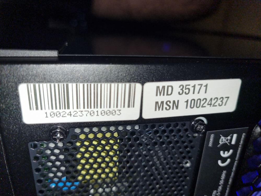

Please post the MSN number, which is on a sticker on the bottom of your PC. Which gives us exact information how your PC was equipped and sold. I can not find the MD 35171.

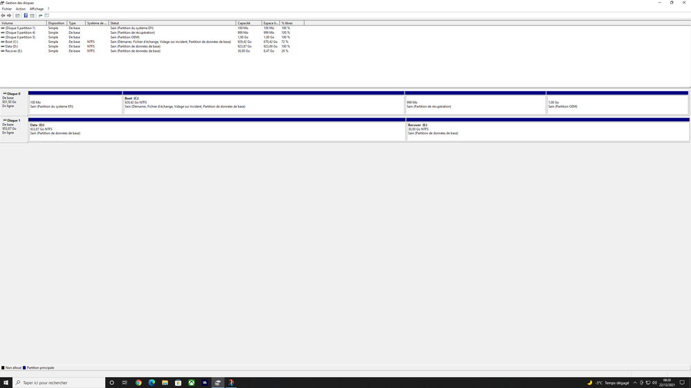

Please check in your disk management, and post a screenshot ( Win Tab plus X --> Disk manmagement )
regards, daddle

About the MSN : 10024237

@FredS59FR
Your informations are  put the "wrong way round". You should look up in disk management.
(Win Tab plus X --> choose  Disk management)
The pictures I can not see yet.  But to understand I do need a screenshot from disk management!

@daddle
Hi, Your explanation is clear.
But as you can see on my photos and on my partition management, the HDD seems to be for C: and SSD for 😧 and E:
As if there were an inversion on the factory assembly ... Is there any solution to correct this ?
thanks again for helping

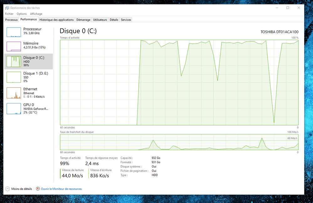

My assumption came from when I did CTRL ALT DEL to see process in progress : in performances page I saw the types of disks written C: HDD and 😧 SSD ... You'll see on photo 2

@FredS59FR
You made use of PowerRecover to recover your installation, you wrote.
Maybe this made the confusion. Normally Windows is installed on the SSD.
If the PC cames like this, I would return  it. Maybe it is a return PC from someone else. Who messed with the installations.  Very unusual, indeed.
Where did you buy it? And in which country are you living? In France?
Well, you could make an Image from your complete HDD, and reflash it to the SSD. But most probably you will loose the content of partition E, with the Recover Image and the Driver - and Tools folder. Those you should save  at first.
But if you change the partition IDs, then PowerRecover will not work anymore. So you can delete it anyway.
A new installation you can always make with the MediaCreationTool from Microsoft.
But it is important to save the Drivers and Tools folder to an extern medium.
Cheers, daddle
