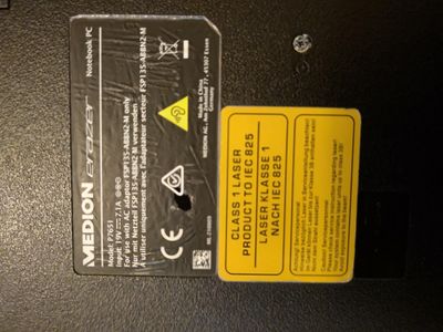

Hey Major Tom,
I can't find the number but I have attached a photograph of the sticker on the back of the laptop. Is there anywhere else I can find it?

Hi @Banton ,
I wasn´t aware of your reply, but to mention a community user in a way that they will be notified when you reply, put an @ sign in front of their name (e.g. @Major_Tom).
Anyhow, the 8-digit MSN should be something like 300233xx but afaik the unit has been solf 5-6 yrs ago, so we might consider hardware related trouble with the battery, or the connected power board, mainboard or something similar.
I also checked the stock situation and the battery does not seem to be available anymore, so we´re really having a challange here.
