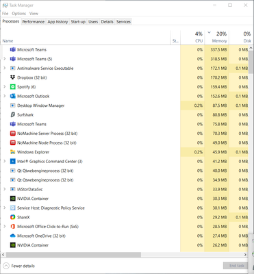

@Gehringer ,
Please see resource use without Gaming Centre installed.

Hi @Sibz,
has this issue been happening since you first bought it or has it started after a few software installation?
Have you already run our Medion Service App to diagnose any faults on your unit?
Have you also tried to perform a factory settings reset of your unit, update Windows and installing the control center? Please test it before installing any additional apps.
