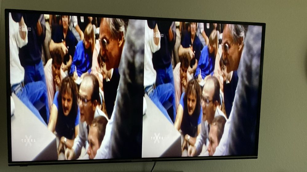

TV MD31555 nach update Zwei Bilder nebeneinander
bin morgen aufgewacht und gemerkt das meine TV MD31555 MSN: 30035208 ein update gemacht.
Was nicht schlimm ist, aber seid dem habe ich zwei Bilder nebeneinander und geht nicht weg.
hab Reststrom und neu Installation alles hast nichts gebracht.
Service PHOTO-2024-06-08-17-19-57.jpg bringt keine Hilfe
danke für ihre Hilfe

i got this morning a email from support too. they want pics from the tv, there is shown the software version installed at the tv. a picture from the failure ( i ve sent one with the 2 homescreens)

Same, i just sent all the pictures, customer NO, serial NO etc...
Why do you think it is an Android software problem? It sure is a software/firmware problem, but it is Medion that prepares and publishes the firmware updates in my opinion?
The split screen also occurs on the cable/AV/satellite mode of the TV. This is not Android...

i thought so, cause the main system is android. probably u have right and medion used a not correct software version .
split screen is a normal function i know from my samsung tv s. and now we cant change back to the single screen mode. i think they have to create a new software function to solve the prob
