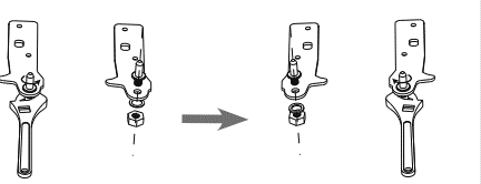

  • The appliance must be in a straight position so that the door is flush with the appliance and then closes properly. First check with a spirit level whether the appliance is level to the back / front and / or to the side. With the adjustable feet, you can compensate for unevenness of the floor and thus bring the appliance into balance.
  • A possible cause can also be the uneven filling of the inner storage surfaces of the door. First remove everything from the door's storage compartments and then test whether the door can be closed properly again. If the door still does not close flush, the hinges may have shifted. These can easily be reattached in the correct position with a suitable screwdriver.
