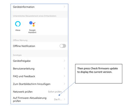

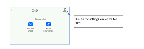

⚠️Note⚠️ To find out the currently installed firmware version, open the settings in the MEDION LIFE+ app of your X40 robot vacuum cleaner by clicking on the corresponding icon in the top right-hand corner and select the option Check for firmware update.
After successfully updating the device firmware to version V0.3.7 and then restarting the robot vacuum cleaner, the error message no longer appears.
