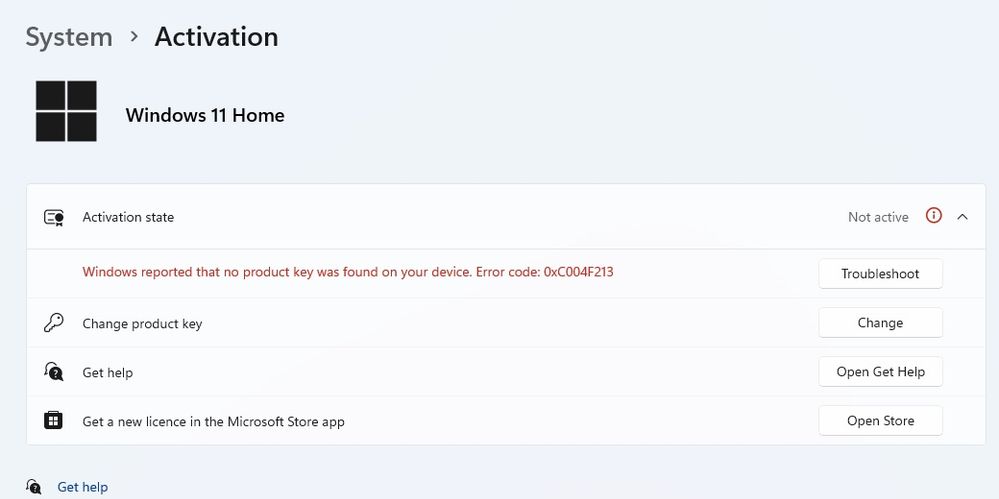

Hello
I just got a new clean Win11 install and this is what the activation status is now:
If I go to troubleshoot and "I recently changed hardware on this device" it guides me through the same steps as before, with the same results.

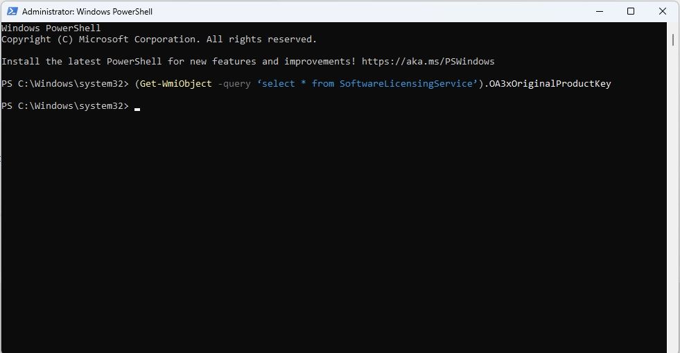

hello @bogsbinny , last try to read the OEM key
open the command prompt (cmd) as admin and enter "wmic path softwarelicensingservice get OA3xOriginalProductKey".
 bye Fishtown

@FishtownI tried that and it just returns: OA3xOriginalProductKey

Running "wmic path softwarelicensingservice get OA3xOriginalProductKey" as @Fishtown said returns no key.
