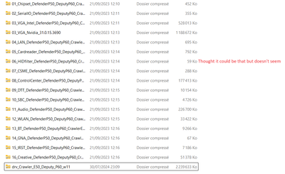

Hi again,

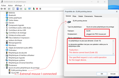

I tried again installing elan drivers, got the same incompatibility warning than first time I tried, and like first time, the touchpad wasn't responding at all after pc restart. However when investigating device manager I found this :
The touch pad, despite not working at all, is now named elan pointing device instead of ps2 mouse. However, what concerns me is the upper red squared message on the picture above telling that the touchpad is plugged in a ps2 mouse port. I hope these information can help you figure out what is happening.

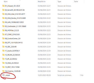

Moreover, can someone provide me with the recommended deputy p60 touchpad drivers. Here are the ones I downloaded here :
https://www.medion.com/fr/service/product-detail/30036599/0571479915?src=my-products
But I can't find which one is supposed to be the touchpad driver

Bonjour @the_dodo
Votre dernière photo montre que les pilotes sont toujours au format ZIP. Vous devez d'abord les décompresser avant de pouvoir les utiliser.

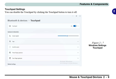

votre pavé tactile est :
C'est ce qui est dit dans le manuel d'entretien Clevo et c'est également décrit comme ceci dans le manuel d'utilisation :
Le contrôle gestuel devrait donc fonctionner.

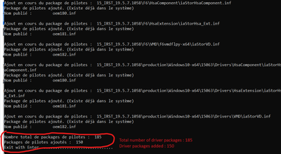

No the photo I took was just to help you or somebody else show me which of the folders contained the touchpad drivers, if there are any. Indeed I had already unzipped the folders to install the drivers. I did it again and this is the console ran thanks to the install file in the drv_Crawler_E50_Deputy_P60_w11 folder unzipped :

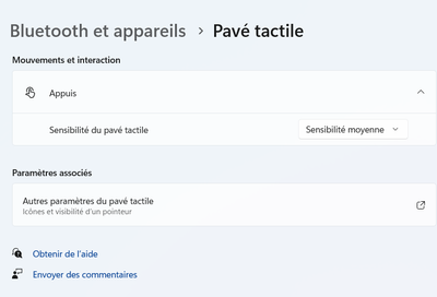

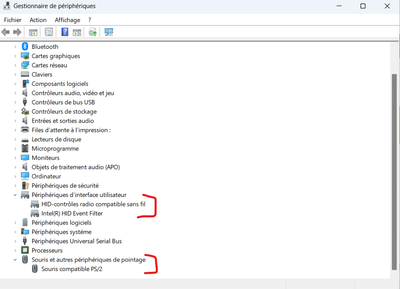

And after installing them and restarting, I still have the problem of the touchpad being recognised as a ps2 mouse with drivers from 2006 and with no gesture options showing up in the w11 touchpad menu :
