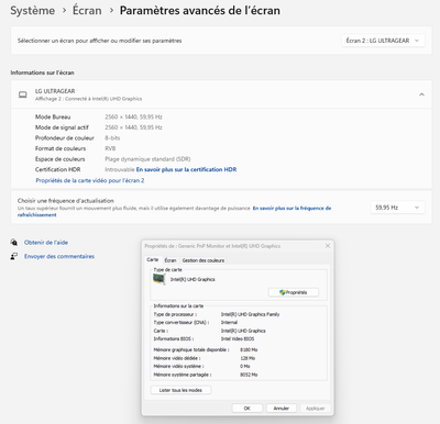

I bought a LG 27gp850 which I plugged in HDMI (I used the HDMI cable provided with the monitor) to my brand new Erazer Deputy P40 (MSN 30035597) but the refresh rate seems limited to 60hz.
It is weird because in the display panel I can change resolution but not the refresh rate (59,95Hz), and it appears as it only recognizes the integrated GPU (when I open the link "GPU properties for Sreen2", it displays the properties of the integrated GPU) :

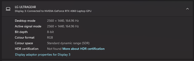

However, Windows (11) also seems to recognize the GPU (Geforce RTX 4060) :

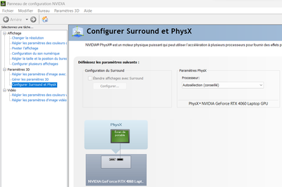

Moreover, in the Nvidia configuration panel it appears as the HDMI port (and the integrated monitor) is only linked with the integrated GPU.

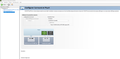

As mentionned by @Cyanogen , I also tried to boot in "Discrete Gpu" mode and the external monitor is no longer detected by the system. It is as the HDMI port vanished...
Only the integrated monitor remains visible and the GPU (RTX4060) seems to run it now  :
I don't know what to think...

Ok so using the DP cable has worked and my monitor is actually using the 4060 at its highest refresh rate.
its quite likely that the issue is that the HDMI cables are just old ones that cap out at 60hz. to get multiple monitors you'll need a DP Hub so you can plug multiple DP cables in and then plug the hub into the laptop via the mini dp port.
