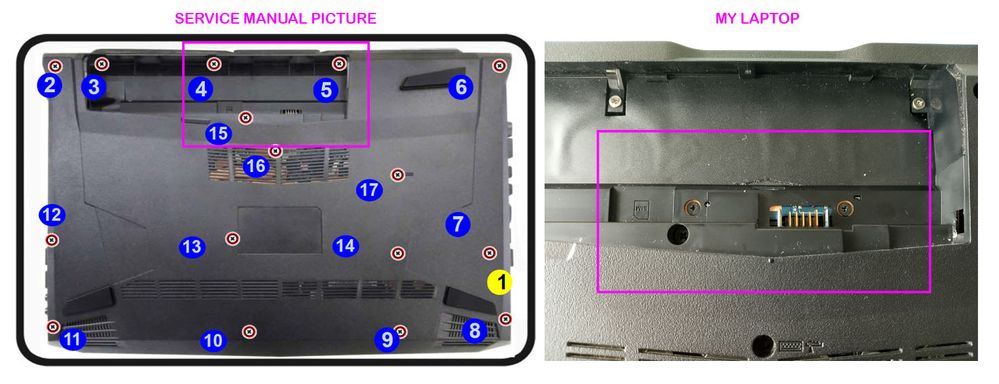

I would like to add RAM to my laptop, but I can't find the instructions for my specific model and I'm worried about a card screwed under the battery that doesn't appear in other P67XX guides.
I know it's my risk, but I have a RAM that I can add to it and right now I can't leave my laptop at a service centre for several days.
MSN 30026020
Erazer P6705 i7-8750H
Thanks in advice

Hi @AnaParra
Strange! what do you mean by map?
do you mean that with the two not shown screws that hold a card?
is probably new and was forgotten to draw. The two screws can also be seen on page 2-5 / Removing the battery.
You may have to loosen it to remove the bottom. just try it out.
bye fishtown
edit: I know what it is. Your on / off switch is located there according to the spare parts list (Power SW Board).
edit1: you don't need to take out the two screws, look here:

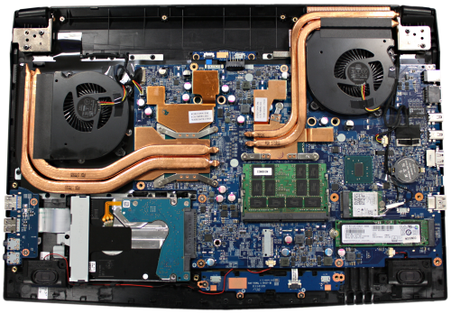

Hi @AnaParra and welcome
RAM: 1x 8192 MB DDR4 SO-DIMM (PC4-19200 / 2400 MHz)
(1/2 belegt; 32 GB max.)
you have a barebone clevo N857EK1, look here for instruction , page 2.6-2.7 and 2.9
Service manual :
https://my.hidrive.com/share/yze8mg-wf8#$/CLEVO%20Service%20Manual%20Books/N_Series/N8/N8xxEx/N8xxEJ...
load N850EK1_SM(20180502).zip
bye and good luck Fishtown

Thank you very much for your quick response.
For some reason my laptop seems to have a few extra steps.
There is a card in my laptop under the battery that doesn't show up in the manual and won't allow me to remove the cover (attached picture) (https://i.gyazo.com/7c70cd65d81f643eda285cde619940f0.jpg).
Any idea what it could be and if it is safe to remove it?

Hi @AnaParra
bye fishtown
