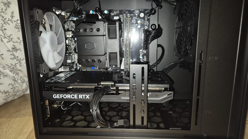

Hello all,
My PC (MEDION - Erazer Bandit P20 Gaming PC - Intel® Core™ i7, RTX 4070, 1 TB SSD) cannot connect to my monitor. I have plugged the HDMI cable in the GPU HDMI port, but it only results in "No Signal" from the monitor. This cannot be from faulty cables because I was able to connect my laptop to my monitor just fine with no issue.

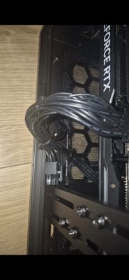

There are some plugs in here and I'm unsure if I should plug them anywhere or if these are just extra wires as a friend suggested. Is this why my PC cannot be detected?

Hello @jirazame and welcome.
what is the MSN number of the computer.

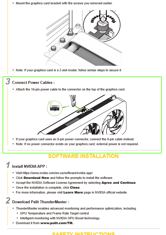

The eight-pin power connector must be connected, so follow the cable to see if it goes to the power supply.
https://www.palit.com/palit/vgapro.php?id=4788&lang=en&pn=NED4070019K9-1047D&tab=ov
Unfortunately it is difficult to see in the pictures.
bye Fishtown
