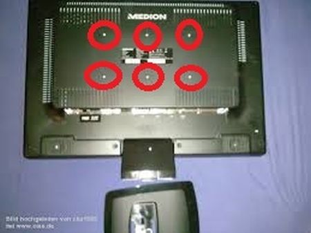

Hi,
I`m dutch, i`m sorry that my german writing is not that good, so i`m writing this in english. German reading is no problem, so please feel free to reply in german. Why i post this question in the german section? The german section is by far the most active Mann (überglücklich)
I have a Akoya P56001/MD20094 monitor for several years now, and i`m still quite happy with it. Now i want to place it on a VESA 100x100 monitor arm. I used a VESA 100x100 to 200x100 adapter plate. I tried the bolts included with the adapter but they don`t fit in the monitor. Could someone please tell me which size bolts would fit in the screw holes on the back of the P56001?
Thanks you very much in advance
Vielen Dank im VorausMann (zwinkernd)

Hallo @QNL und herzlich willkommen in der Community.
Ich habe mir eben einmal die technischen Unterlagen zu dem Monitor angesehen und konnte leider keine Angaben zu den Schraublöchern finden. Normalerweise kommen bei solchen Halterungen aber M4 Maschinenschrauben zum Einsatz. Solche Schrauben bekommst du in jedem Baumarkt. Achte bitte darauf, dass du keine zu langen Schrauben verwendest, um nichts im Inneren des Gerätes zu beschädigen. Welche Länge du genau brauchst, wirst du wahrscheinlich ausprobieren müssen. Vielleicht kannst du den Monitor mit ins Geschäft nehmen und testen, welche Schrauben du brauchst. So kaufst du nicht die falschen.

Hi Andi, Thanks for your reply. The "Schraublöchern" were indeed for standard M4 "Schrauben". I bought some at the "Baumarkt". And now my two MD 20094`s are connected very solid trough an(200*100 to 100*100) adapter with a Newstar monitor-arm. They look great and finally i can adjust the height, etc. I know these are old-TN panels, but years ago i bought them as a bargain at a local Aldi special Sale-event. Still happy with them and i won`t swap them for 4k or ips as long as they`re good. Kind regards, QNL
