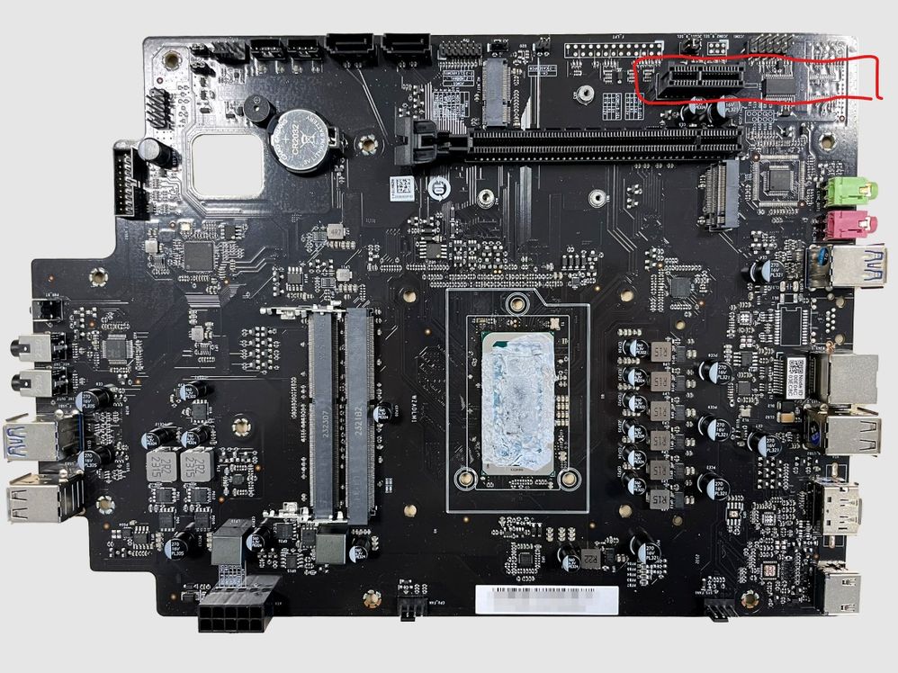

Greetings,
I bought the Medion T80 Mini PC (store page) (specification sheet - de).
I want to add an additional 2.5 inch SSD to the computer but I can't figure out what power connector this is other than the data SATA port.
* Image attached below
The power one has 4 pins and is labelled SATA_PWR1, SATA_PWR2 etc.
Additionally, if anyone knows where I can purchase this connector in Germany, please let me know.
Thanks in advance.

Yes, I came across these posts when searching for the connector and it mentions the power connector as a 5/12 4-pin power connector but I could not find it in the box the mini PC came in.
Would the correct connector for the power be JST with SATA (like this one)? I am a bit worried about picking the wrong one since I read that they can vary (with respect to different pinouts) so I wanted to confirm.
I also want to ask if I can contact medion in any way to send me the correct connector.

I bought a
M.2 SSD PCI Express NVMe adapter (faster than SATA)
https://www.amazon.nl/dp/B0CP5QK5N5?ref_=pe_28126711_487767311_302_E_DDE_dt_1
https://www.amazon.nl/dp/B0B55SWRCY?ref_=pe_28126711_487767311_302_E_DDE_dt_1&th=1
The ssd remains cool with the graphene cooling sticker (don't need the aluminum heat sink)
Insert the adapter into the PCIe slot (break away metal plate first). Boot the PC. Partition the SSD. Done!
Schermafbeelding 2025-05-14 205207.jpgSchermafbeelding 2025-05-14 210230.jpg
