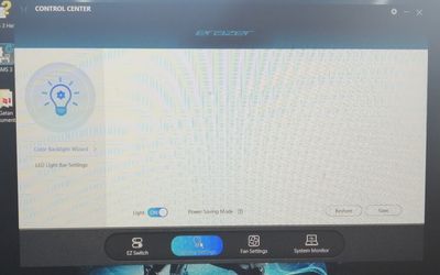

Hi @Gehringer, thank you again for your feedback. The gaming centre you forwarded me is the same one I have. The problem hasn't gone away. Please see the image below. When I go into control centre the lighting settings for the KB don't show up. It works fine for the LED light settings but not for the KB. I have already, checked if an external KB would work but it seems indeed that the in-built KB overrides the external one too. I have also uninstalled and reinstalled the latest KB drivers manually and via Windows' auto device manager update. The Medion tech support guys also suggested I plugin an external keyboard to alleviate the problem. I also performed a device reset using Windows' internal protocol but the problem pops up again after a few minutes. It took about 10 minutes for the KB to be glitchy after resetting the device.
I will attempt to disable the internal KB during startup in the BIOS.
